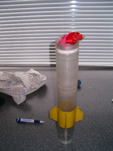

I use 90sec epoxy resin for the symmetrical splice. I have tested the bottle to 7 bar of pressure. Can't test it with a higher pressure since I am forced to use my dads compresser. In the flight shown in the video that robby has uploaded I filled the bottle with approximately 33% of rocket "fuel". The fuel is made of 67% water and 33% soape. I use this mix, since it leaves a breif foam trace on the sky. I pressurized the rocket to 6 bar via the Gardena system and launched. The entire rocket as launched is at the picture below. I know that I have teaken the nosecone of, so maybe the reduced highed is because of higher drag. I removed the parachute section off for this flight since I just cant make it work. Am going to work on it today, the problem is that the parachute won't come out of the chamber.
@ Speckknoedel, you talk about a pro-system. What is that??
The second photo below shows the rocket at the launchpad including the parachute section. The weight of the entire rocket including parachute section, but without water is about 190 grams. And the nossle diameter is standard Gardena I think about 10mm.
