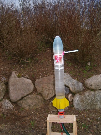

Second photo

hi rocket raz
the "profi system has a bigger nozzle size.
PMbond

Yes,its 16mm,very coolwink
Your rocket looks like a real onestick out tongue
The Parachute-system is with an timer??
But 190gr are a little much for this little rocket.
You should test the ss Technik with more bottles.

Moin!
@ rocket:
Hey, 190 gr are ok, i think. My red one flies at 700-800 gr.
@ rocket-raz:
first of all: respect, very cool rocket.
Your parachute won´t come out? Try to wrap the chute into
a piece of darcon. It´s a material normally used at kites to
make the sail more stable.
See a picture of a wrapped chute here:
http://www.raketenmodellbau.org/showthread.php?s=&threadid=3573&perpage=10&pagenumber=2
see a video of an unwrapping chute here:
http://mitglied.lycos.de/robby2004/gelber%20Flug1.WMV
Or you can try to put the chute in a small pocket before loading
it into the parachute chamber.
It´s important to reduce the friction between the chute and
the walls of the chamber.
Please, don´t try to increase the pressure of your rocket.
9 or 10 bars could be too much because of the epoxy adhesive
you use. Do you know polyurethane containing adhesive?
It´s the best stuff for PET bottles.
What experiences do you have made with this rocket fuel,
this mix of water and soap? Does the rocket fly higher?
Greetz Robert
