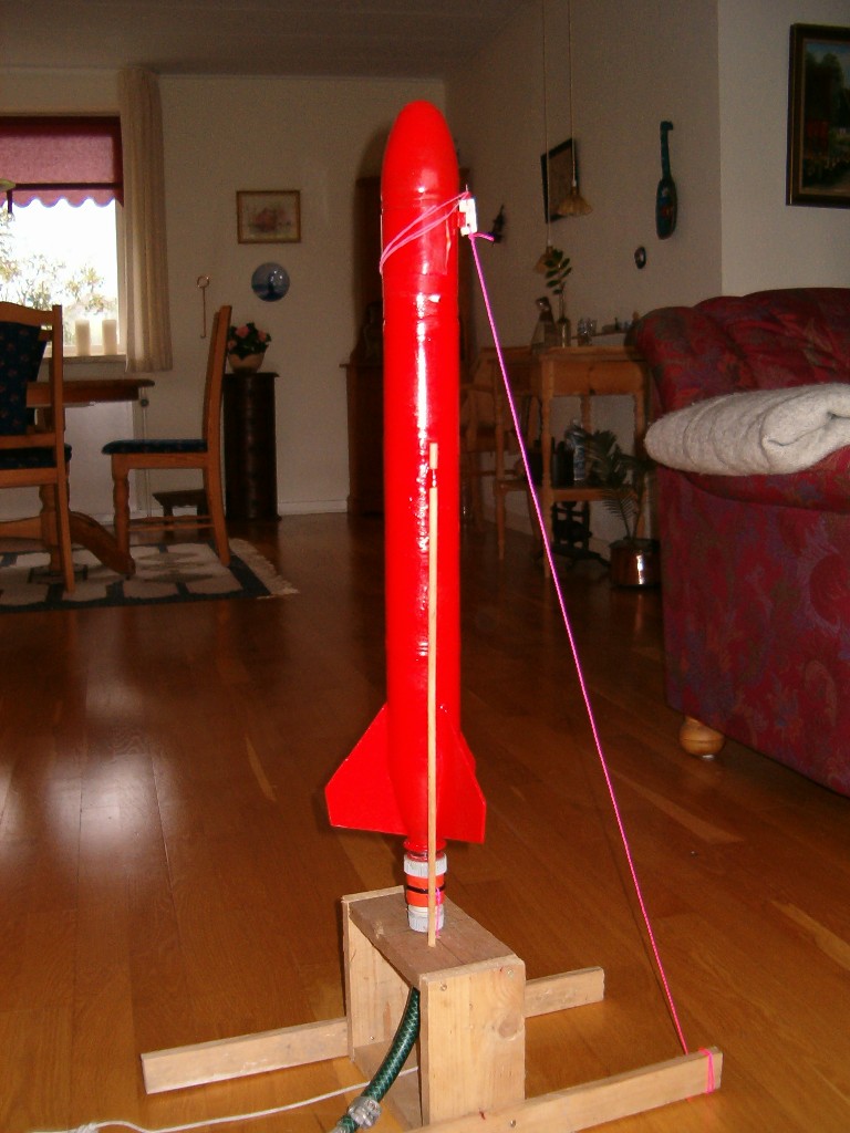

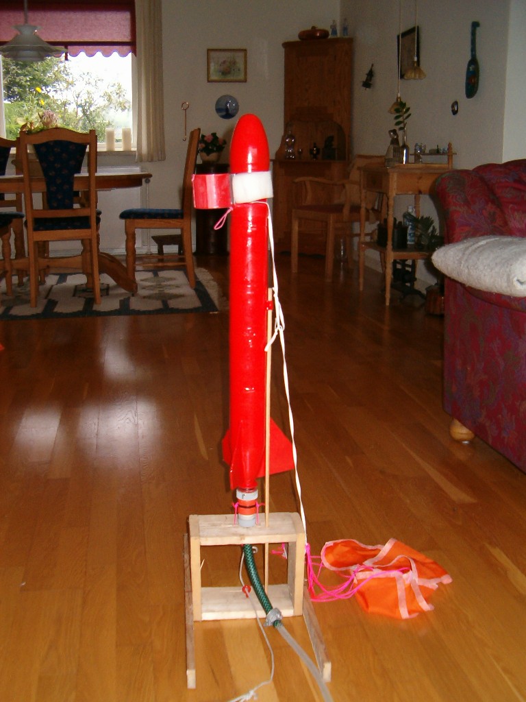

Hi everyone
Here is the latest news from Denmark. First of all I am sorry writing you in English, but I fear that if I had written in my (BAD) German you wouldn’t understand a word. Please forgive me. Finally I’ve got time to work on my water rockets, and here is my new rocket. I’ve encountered some problems doing the manufacturing process as well as now, but I will tell you later. First of all here is the data of my new rocket, which is made of 0.5L recycle bottles. Length 66.0 cm. Max diameter 6.5 cm Weight 250 grams Pressure tank volume 1300mL Parachute deployment system Tomy Timer and X-type parachute Nozzle Standard Gardena-Type nozzle. 1cm Diameter. Number of fins 3, made out of “hardback” book covers. Pressure test. Tested at 10 bars, launch will properly be 8 or 9 bar. General description of the rocket: The pressure tank is made of 0.5L recycle bottles. The bottles where spliced with the Symmetrical Splice Technique using PU-glue. I had trouble making sure the spliced sections were straight. Do you splice one section or them all at the same time. The three fins are made out of “hardback” book covers glued on with PU-glue. The parachute section is made much alike those pictured on Raketenmodellbau.org with Tomy Timer, sponge and X-type parachute. Could anyone tell me how to pack X-type parachutes, and regular circular parachutes? Which kind of fabric do you use to make your parachutes. Also the “door” of my parachute recovery system has a tendency to stay closed, as the Tomy Timer has released the rubber band, I have tried to loosen the rubber band a little, but then the “door” won’t close completely. Does anyone have a suggestion on how to fix this problem? Nose cone is made of the top of a bottle, with a table tennis ball glued in place. The entire rocket is spray painted with red paint. I have experienced that other colures of the same product will run. Do you use primers before painting?? Now, I haven’t flown the rocket yet of two reasons. First the weather hasn’t allowed it yet, and two and more importantly I can’t establish if the rocket is stable in flight. Can anyone tell me how I can test this? Finally I have attached some pictures. With kind regards. Rasmus Folgende Datei wurde angehängt: |
