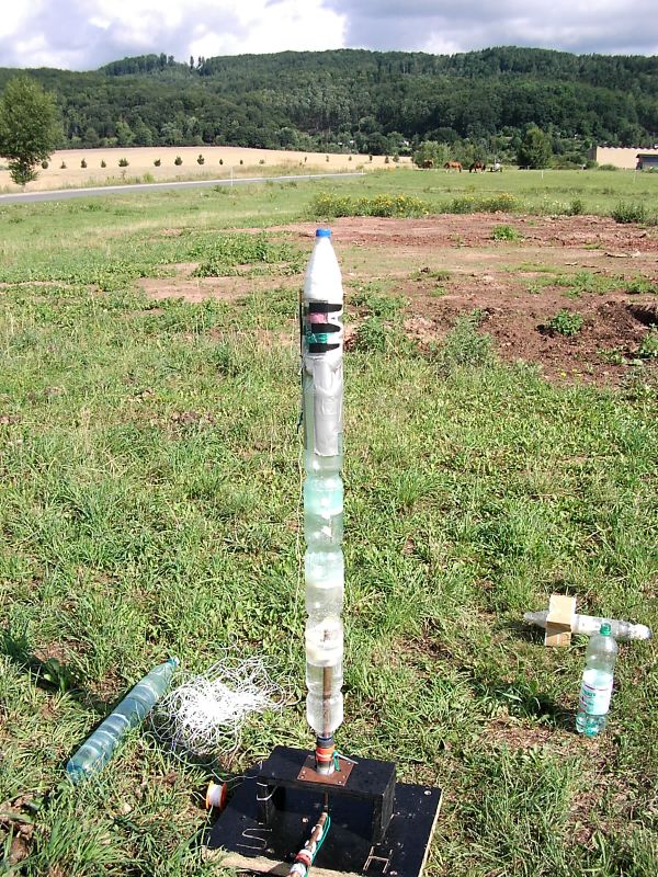

picture 3
parachute section Folgende Datei wurde angehängt: |

Hi
rocket-taz, your rocket looks absolutly perfect... Sorry für mein schlechtes Englisch, sind halt ferien... Gruß PMbond |
Beitrag 81207
Hi rocket-raz!
Like pmbond said: absolutely perfect! really!(sorry for my bad english but i´ll try to answer)Your rocket looks very straight. You had problems with it? Hm. First of all, you have to ensure, that the sections were cutted in a perfect right angle. So the rocket also will become straight. Do you use a kind of device to cut the bottles? On this side you can see those devices. I splice all sections at the same time. Take a look at this Side to read more about packing a regular parachute. There´s also a side that describes the steps of packing a x-type parachute, but i can´t find it now. The door of the parachute chamber won´t open? Hm. You use a sponge to eject the parachute. Try to take a bigger sponge. Or you use rubber bands to eject the chute. I don´t use primers before painting and glueing, but i´m cleaning the rocket with acetone. Bad weather in denmark? Yep!! I was there for holiday two weeks ago. Very, very, very bad weather. If you want to find out if you rocket is stable in flight, you can do the so called swing test: Attach a rope at your rocket at the center of gravity: it´s located quite in the middle of the rocket. The nose and the nozzle of the rocket has to level in a horizontal line, so the complete rocket has to hang in a horizontal position on the rope. Next you take te rope with the rocket attached on it and swing it around over your head. Or you hold it in the wind (there´s enough wind in denmark )The nose of your rocket has to point in wind direction. If it does not, attach some weight at the nose or attach bigger fins. Understood? good luck! I hope, my english is not too bad . Greetings Robert |

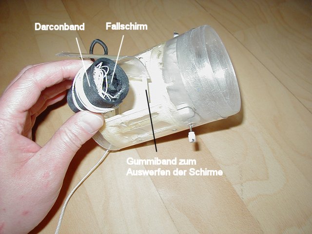

Au Schiet! Ist denn viel kaputtgegangen an deiner Rakete?
Ist bei dem Flug zumindest die Tür aufgegangen? Es ist ganz wichtig, dass der Schirm ohne Widerstand aus der Fallschirmkammer fallen kann. Dazu wickel ich den Schirm immer in so ein Darconband ein. Dadurch bekommt man ein Fallschirmpäckchen, dass wie ein Sushi gerollt ist. Das fällt dann ganz leicht aus der Kammer. Natürlich braucht man noch ein Gummi oder halt eine Schwamm, um den Schirm auszuwerfen. Aber die Leichtgängigkeit des ganzen ist der Schlüssel zum Erfolg. Hier wird das System nochmal genauer beschrieben. Auf dem Bild unten kann man nochmal das Fallschirmpaket sehen. Äh, mach dir keine Sorgen, dass wir hier nur noch englisch schreiben ...und nu poof mal ne Runde Gruß Robert Folgende Datei wurde angehängt: |

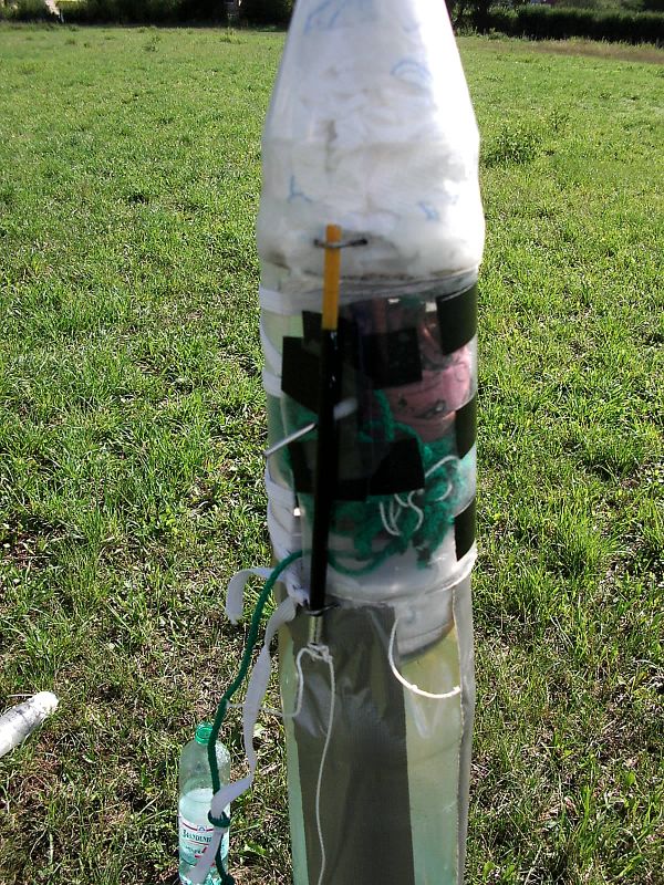

So nun mal die bilder die lange schon auf meiner kamera waren natürlich unscharf wie immer.
Hier erstmal eine übersicht des Ganzen. Folgende Datei wurde angehängt: |

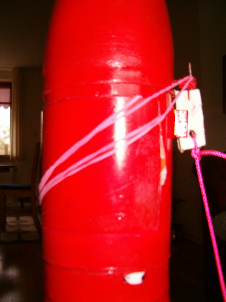

so ok nun mal die kammer an sich ist nur mit power tape festgeklebt weil sich bei meinem vater nix vernünftiges finden ließ. Folgende Datei wurde angehängt: |
