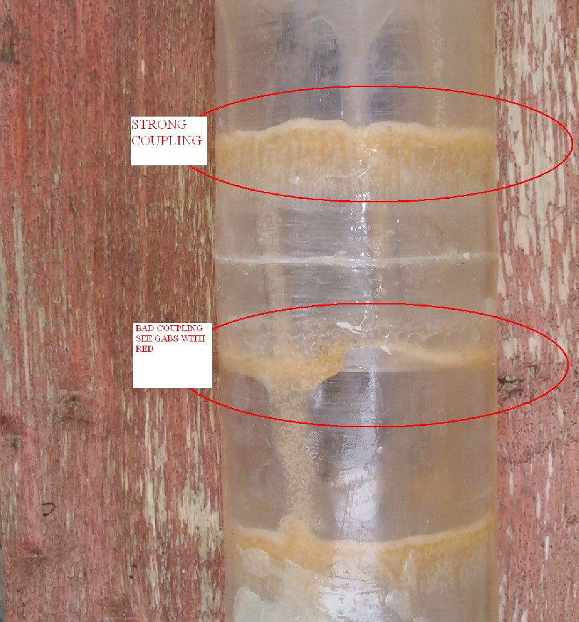

Trying one more time
MarkusJ
Wohnort: Kandel
Beiträge: 2148
Beitrag 82325 [Alter Beitrag07. September 2005 um 15:36]
my glue parts don't look so much better ...

My glue also runs down and my glue parts look the same, but I never hab problems with pressure. Do you have some?

I don't think this will be a major problem, if only there is enough glue between the sst. What runs down should only be the part of the glue that is too much.
Beitrag 82336 [Alter Beitrag07. September 2005 um 18:40]
Yep, but note this: the smaller the split between the glued parts, the
stronger will the connection be!
So you have to ensure a small split.
@ rocket-raz:
what method do you use to shrink the bottles?
hot water? a hot iron?
Greetings Robert

I am using hot water. Can't get the ironing method to work properly.
Am going to try making a new pressure tank, where I will try making the shrinked part of the couplings as small as possible, and also flipping the tank during the drying process making the glue fill out the gabs, where it has run out.

i allways glue only one pipe and one joint and clean the free part of the joint immediaty.
On the next day you can inpect the parts and sort out or repair the parts with failures.
Then glue all of these pipe-joint peaces to a big tank. Possition all the parts in a direction that the glue can run in the splits so the problem will be fixed.

This sounds like a good idear. This will ensure that all the joints are glued properly
This could be the problem! If you use hot water, the shrinked section will be a little
bit longer. Perhaps 10 mm or more. And that´s too much.
Try to exercise the hot iron method. This will make the shrinked section shorter.
Pay attention, the diameter of the shrinked section has to be only a little bit (max 2 mm)
smaller than the original diameter.
